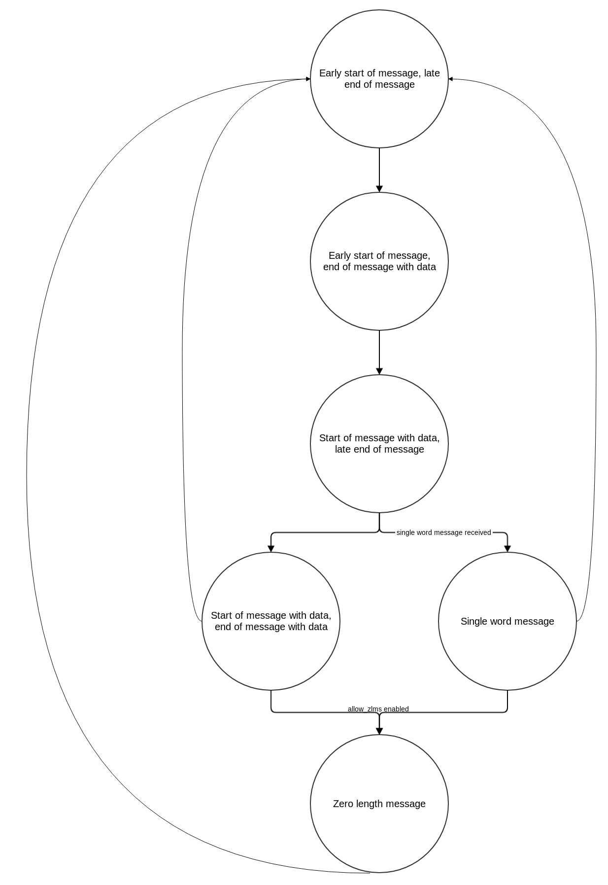

Finite State Machine
The following figure shows an abbreviated representation of the primary finite state machine implemented in the HDL version of the metadata stressor component.
Metadata Stressor HDL Worker Finite State Machine
Figure 6: Metadata Stressor HDL Worker Finite State Machine
