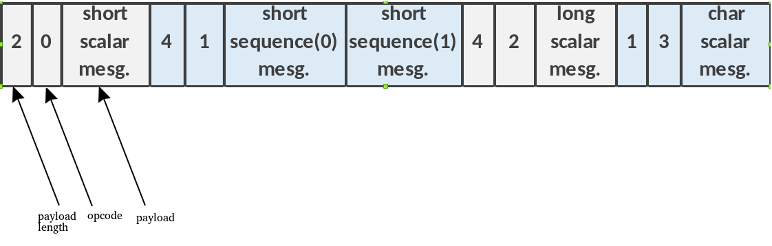

In messaging mode, the contents of the file are interpreted as a sequence of defined messages with an 8-byte header in the file itself preceding the data for each message. This header contains the message length and opcode, with the message data contents following the header. The length can be zero, which means that a message will be sent with the indicated opcode, but the message will carry no data.
The first 32-bit word of the header is interpreted as the message length in bytes, little endian. The next 8-bit byte is the opcode of the message, followed by three padding bytes. For example, in the C language (on a little-endian processor):

The messaging file field layout is shown in Figure 3:
Messaging File Field Layout
Figure 3: Messaging File Field Layout
