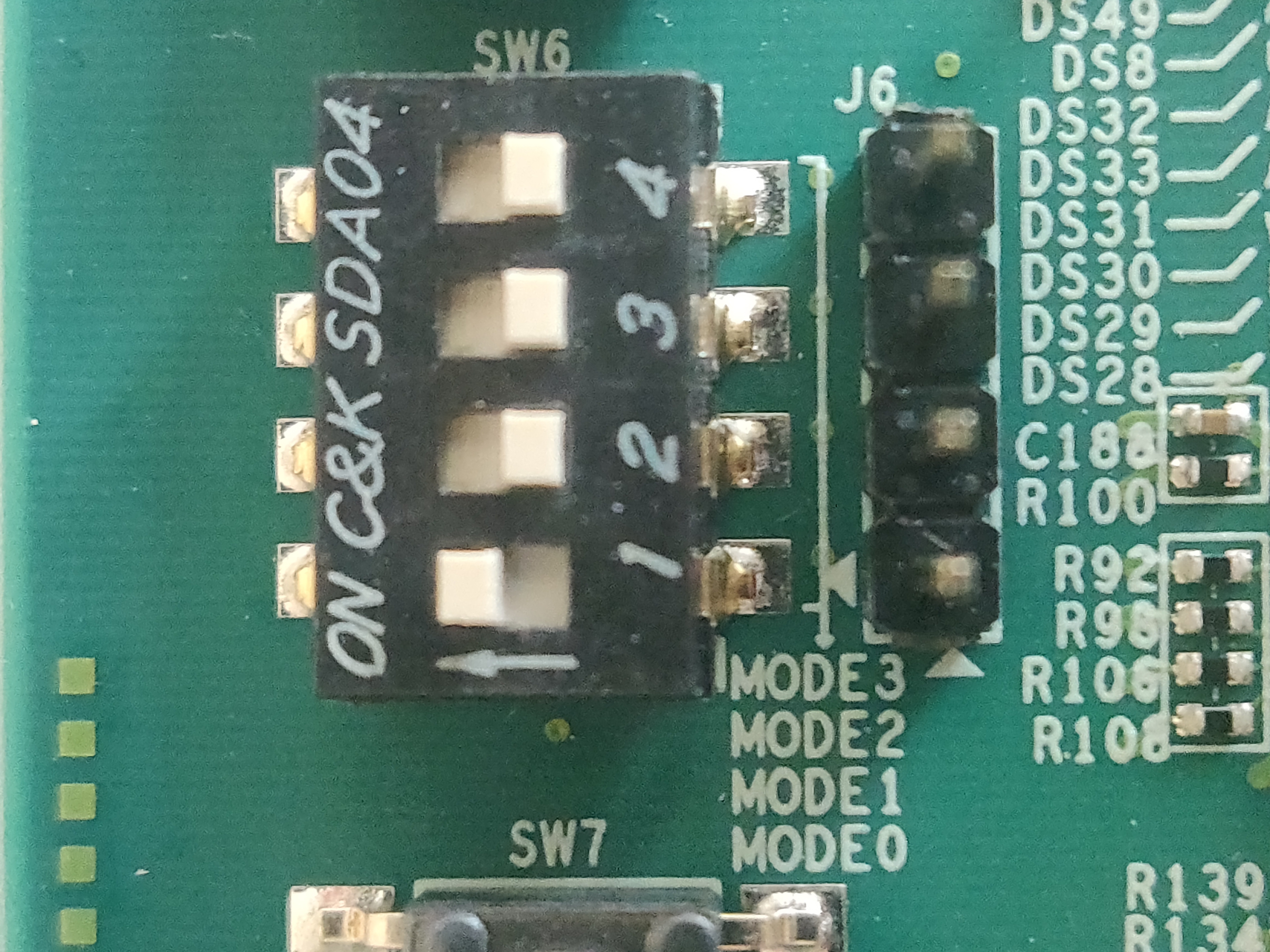

Configuring the ZCU111 to Boot from an SD Card
By default, the boot mode switch on the ZCU111 is set to boot from the Quad Serial Peripheral Interface (QSPI). Set this switch (SW6[4:1]) to the positions shown in Figure 6: so that the ZCU111 will boot from the SD card. See the section “RFSoC Device Configuration” in the ZCU111 User Guide at https://www.xilinx.com/support/documents/boards_and_kits/zcu111/ug1271-zcu111-eval-bd.pdf for details.
Figure 6: Xilinx ZCU111: Top View with SD Card Boot Mode Switch Settings

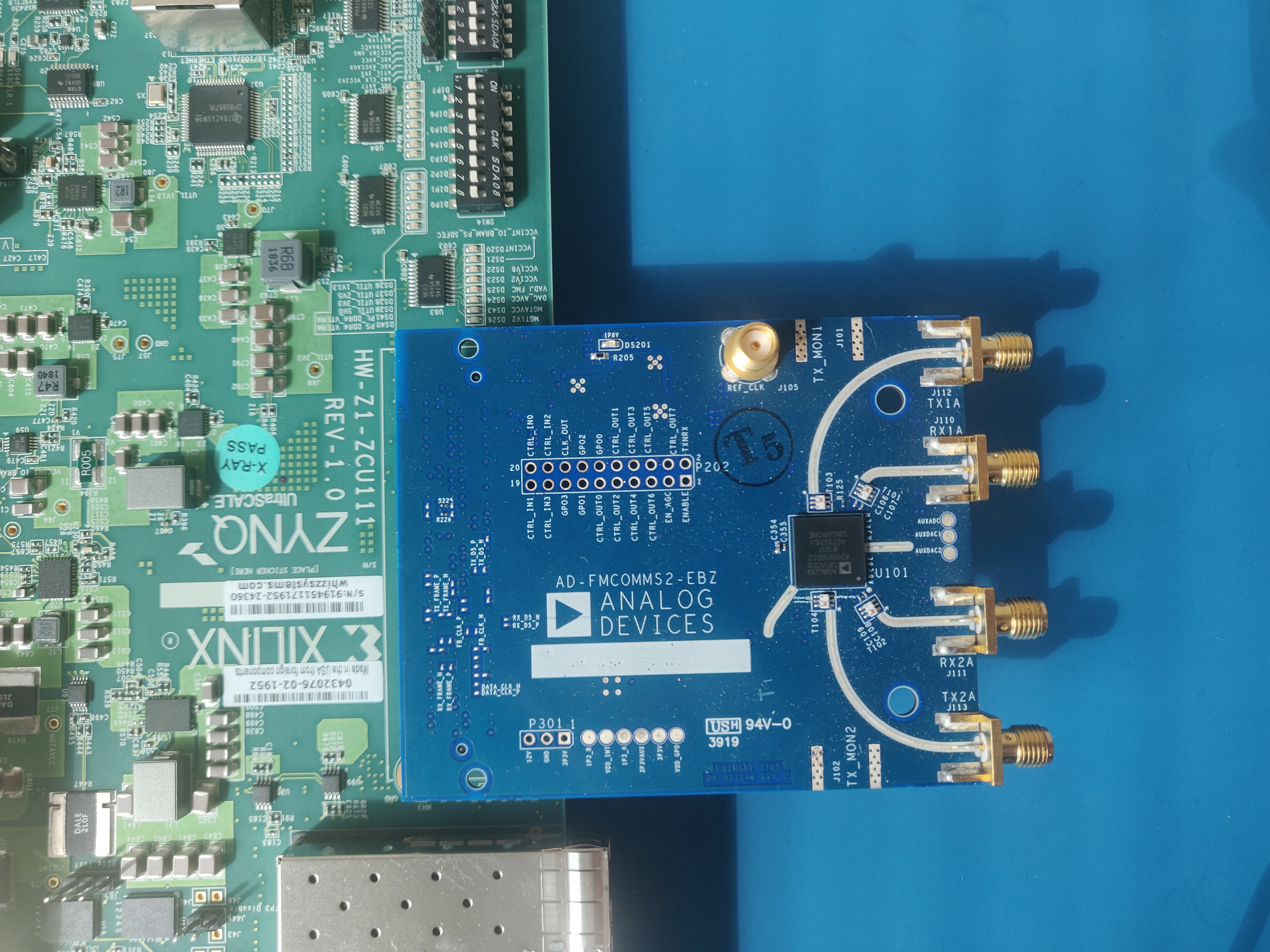

The ZCU111 has one FPGA Mezzanine Card Plus (FMC+) slot that can be used to connect FMC plug-in modules or daughtercards, as shown in Figure 7:. OpenCPI currently supports two daughtercards that can be installed on the ZCU111:
Figure 7: Xilinx ZCU111: Installed FMCOMMS2

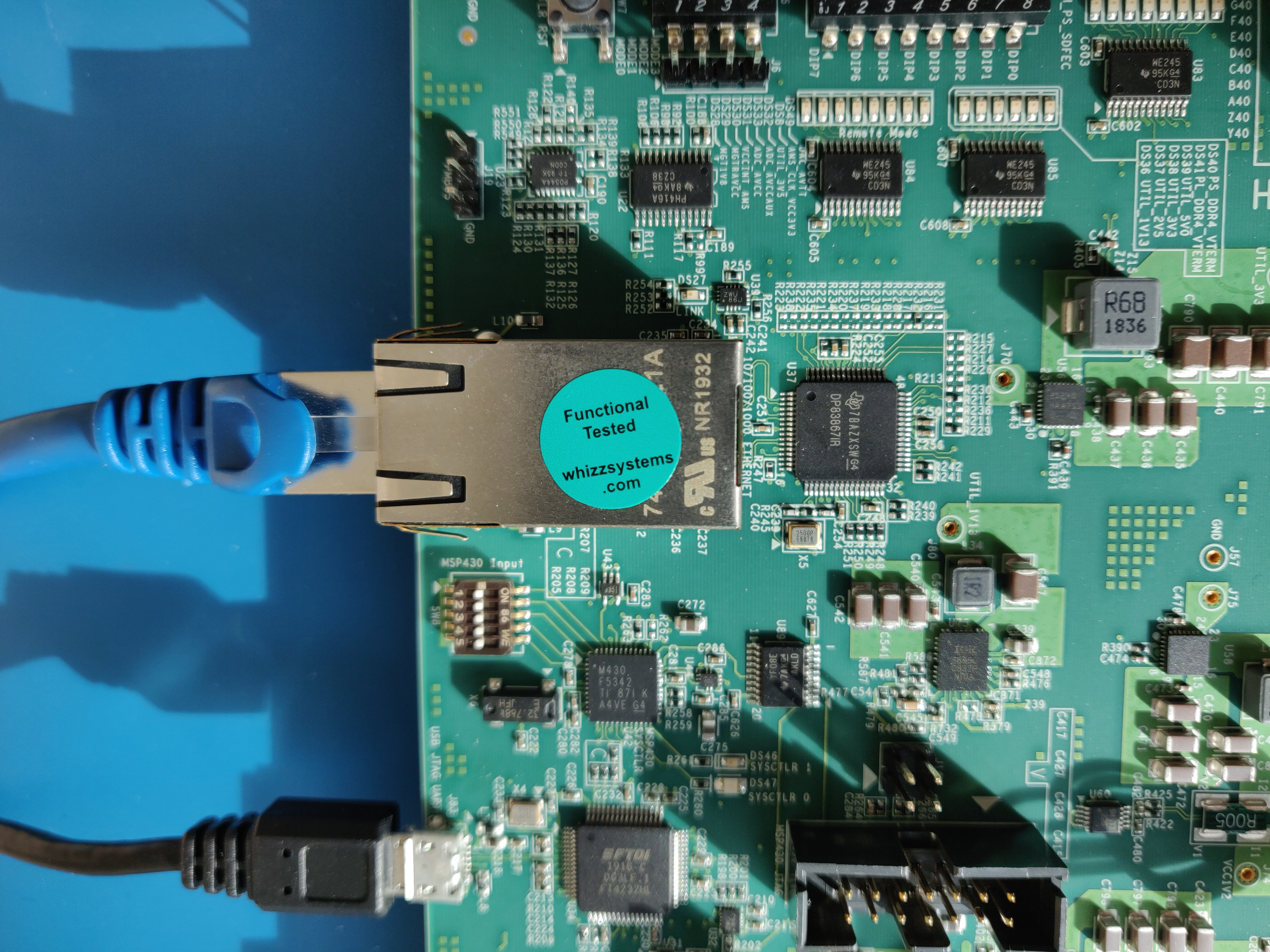

Using server mode or network mode for OpenCPI on the ZCU111 embedded system requires establishing an Ethernet connection from the ZCU111 to a network that supports DHCP.
There is one Ethernet port located on the ZCU111, as shown in Figure 8:. Use a 1-Gigabit Ethernet cable to connect this port to the DHCP-supported network.
Figure 8: Xilinx ZCU111: Ethernet Port

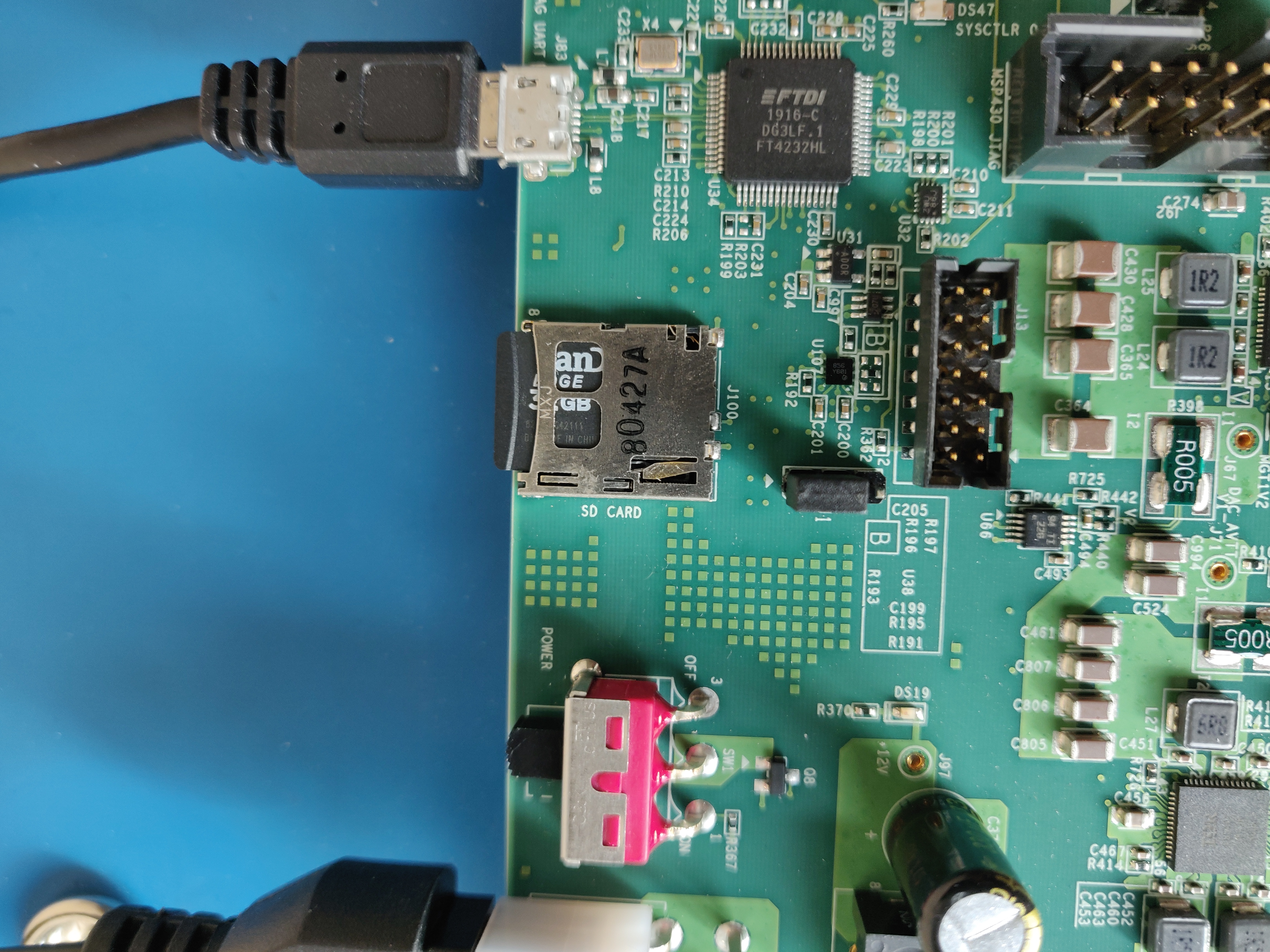

The bootable SD card slot is located next to the power switch and the micro-USB serial port, as shown in Figure 9:
Figure 9: Xilinx ZCU111: microSD Card

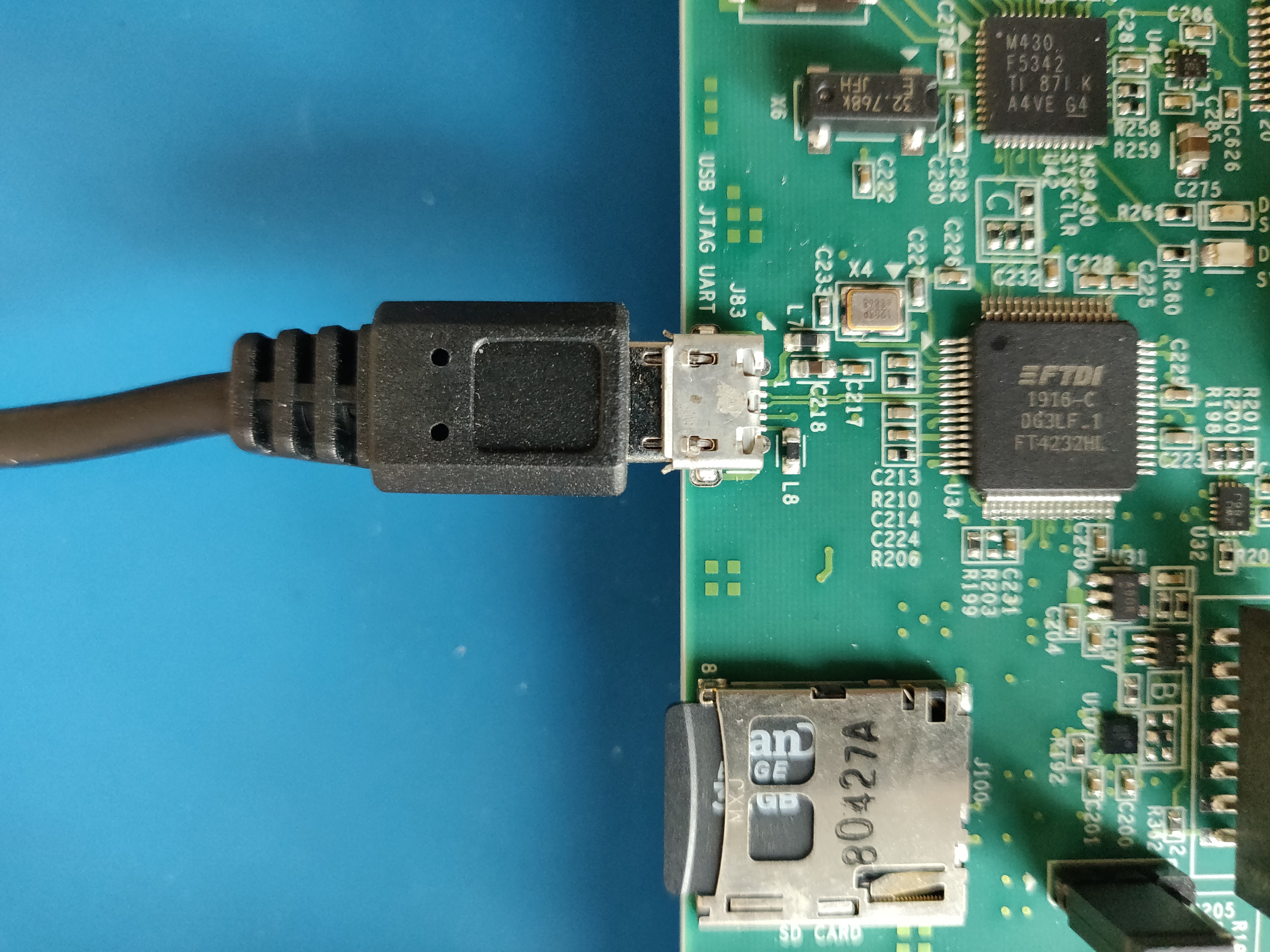

On the ZCU111 system, the micro-USB serial port is located on the top side of the ZCU111 as shown in Figure 10: and is labeled USB JTAG UART/J83.
Figure 10: Xilinx ZCU111: micro-USB Serial Port
Connect the micro-USB to USB-A cable from this port to the development host.
The ZCU111 serial USB port operates at 115200 baud.

Insert the prepared SD card into the SD card slot on the ZCU111, as shown in Figure 9:.
