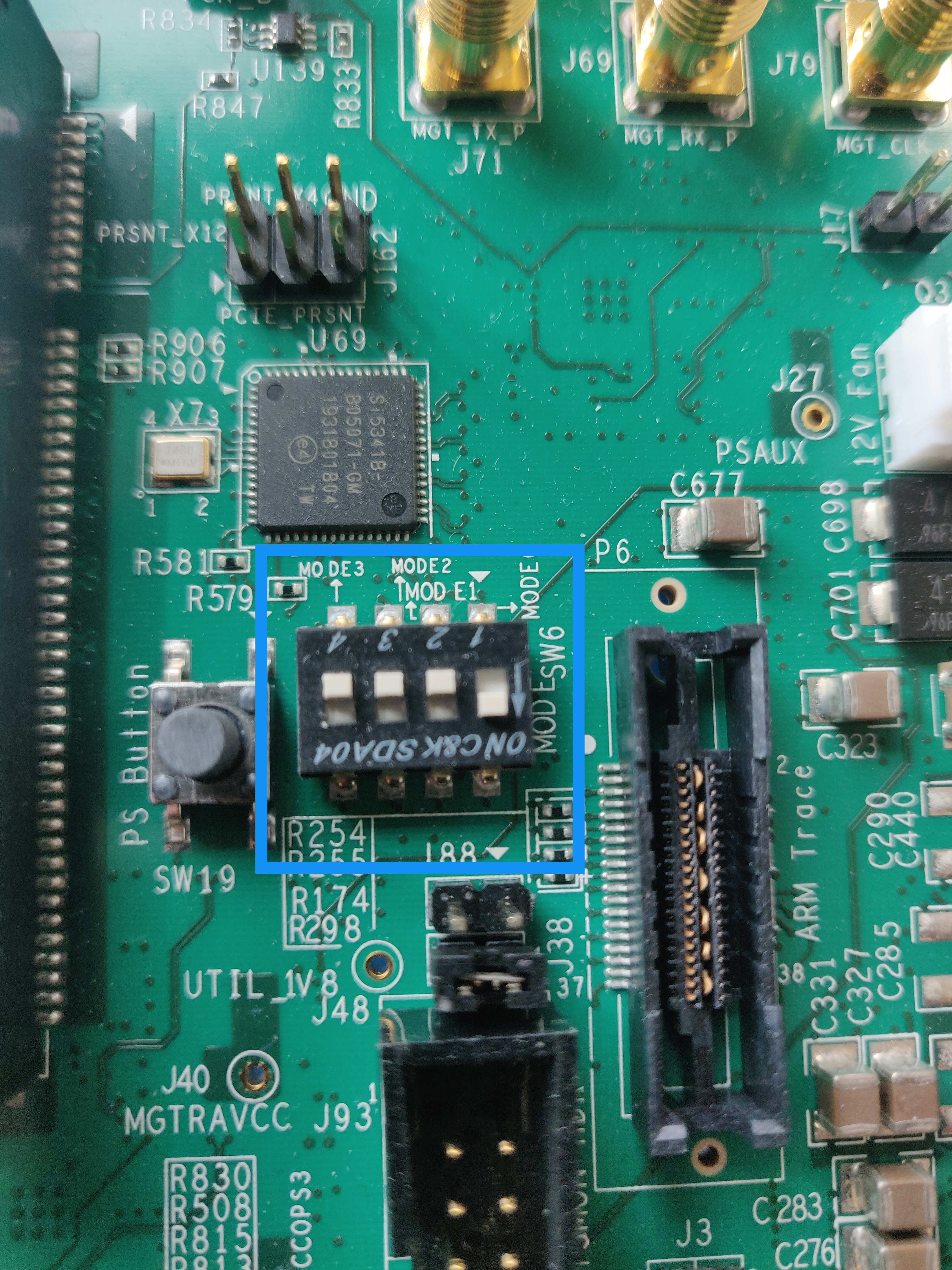

By default, the boot mode switch on the ZCU102 is set to boot from the Quad Serial Peripheral Interface (QSPI). Set this switch (SW6[4:1]) to the positions shown in Figure 1: so that the ZCU102 will boot from the SD card. See the section “MPSoC Device Configuration” in the ZCU102 User Guide at https://www.xilinx.com/support/documents/boards_and_kits/zcu102/ug1182-zcu102-eval-bd.pdf for details.
Figure 1: Xilinx ZCU102: Top View with SD Card Boot Mode Switch Settings

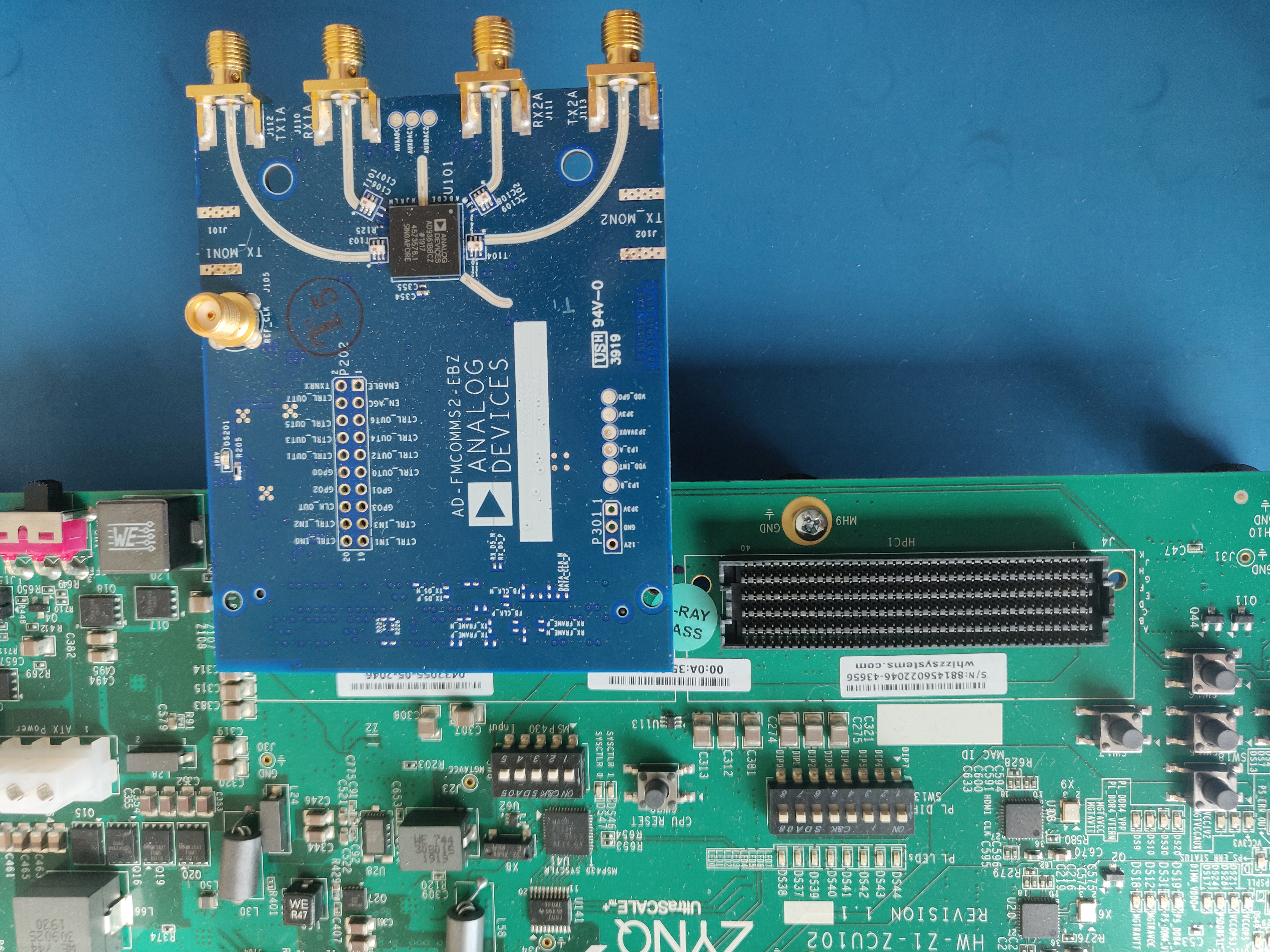

The ZCU102 has two FPGA Mezzanine Card (FMC) High Pin Count (HPC) slots that can be used to connect FMC plug-in modules or daughtercards, as shown in Figure 2:. OpenCPI currently supports two daughtercards that can be installed on the ZCU102:
Figure 2: Xilinx ZCU102: Installed FMCOMMS2

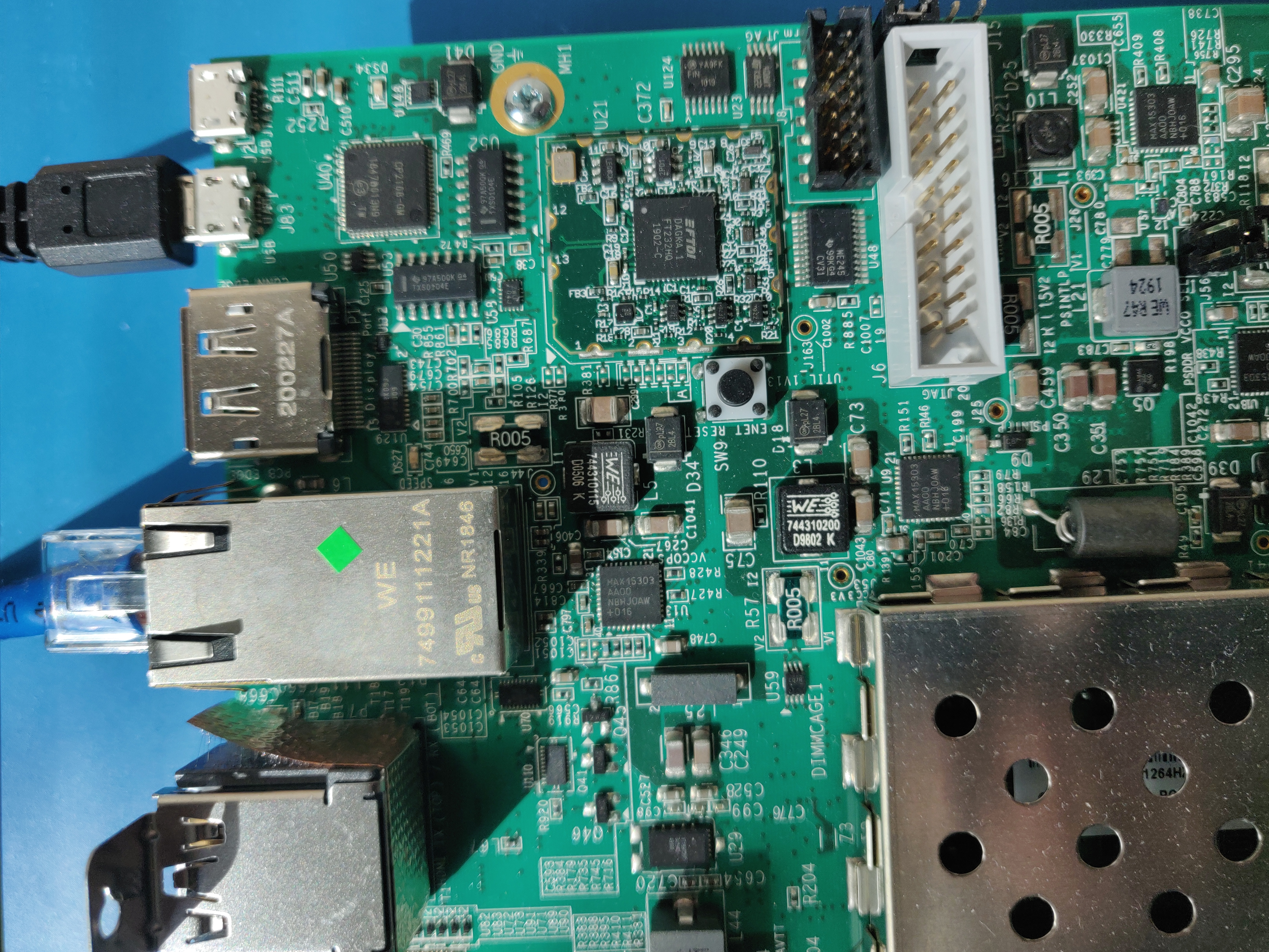

There is one Ethernet port located on the ZCU102, as shown in Figure 3:. Use a 1-Gigabit Ethernet cable to connect this port to the DHCP-supported network.
Figure 3: Xilinx ZCU102: Ethernet Port

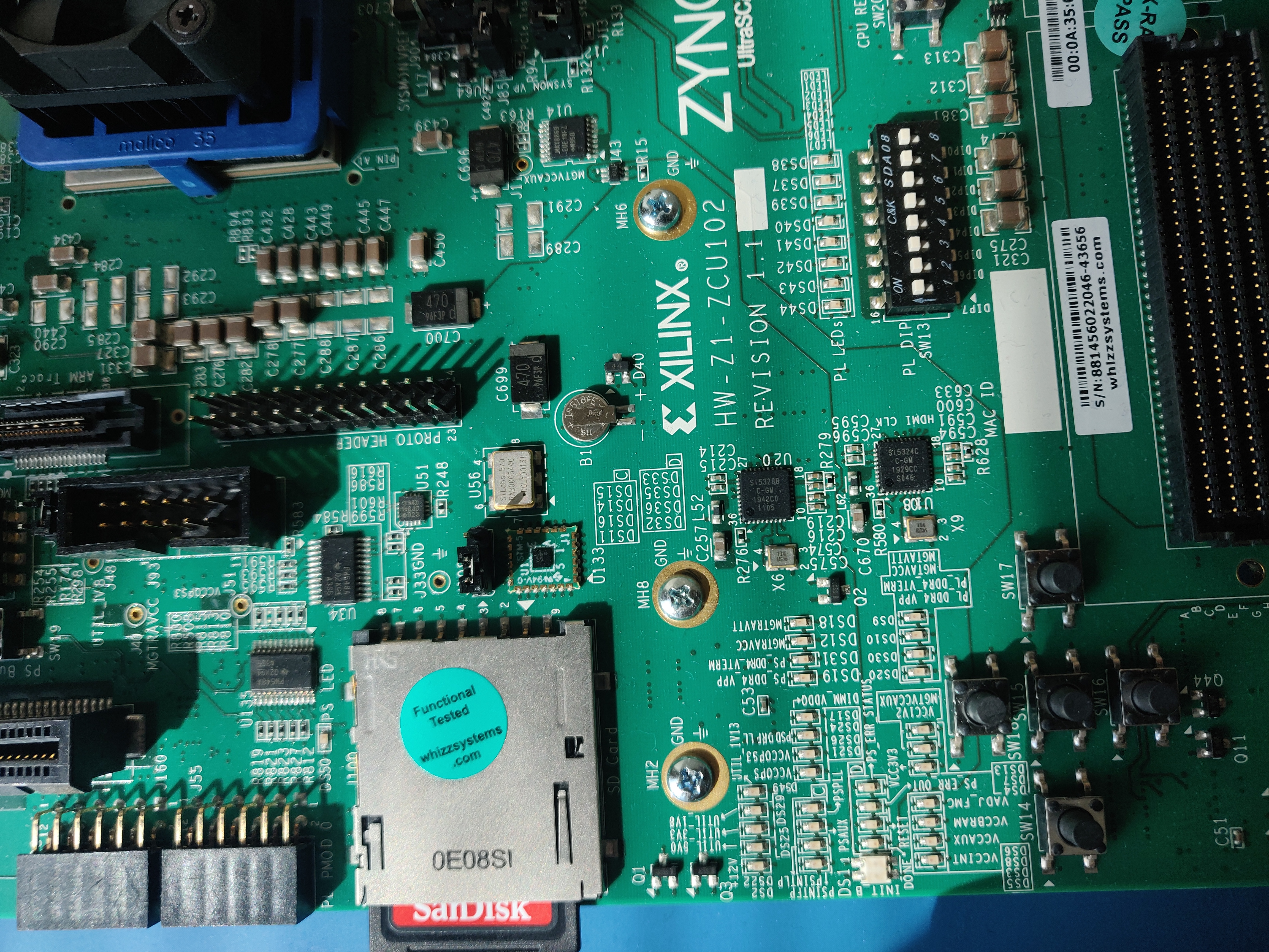

The bootable SD card slot is located above the directional pushbuttons, as shown in Figure 4:
Figure 4: Xilinx ZCU102: microSD Card
