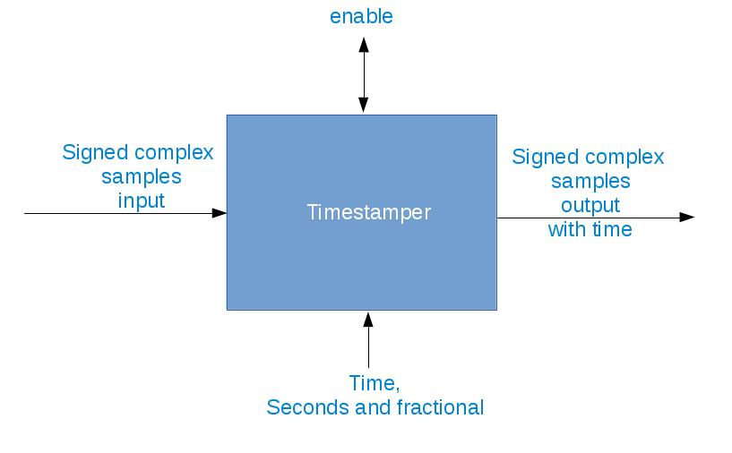

Inputs complex IQ data and outputs complex IQ data prepended with a timestamp. One timestamp is sent for each data message produced on the output.
A block diagram representation of the implementation is given in Figure 5:
Figure 5: Timestamper Block Diagram

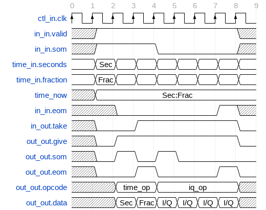

Timestamps are provided as an input to the component on the time interface. The timestamp is a 64-bit number with the first 32 bits corresponding to seconds and the last 32 bits corresponding to fractional seconds. When a valid message is detected on the input, the timestamp is registered by the component and given on the output interface. Timestamps and data are given on the output interface using different opcodes.

A timing diagram of the output interface for the timestamper component is given in Figure 6:
Figure 6: Timestamper Output Timing Diagram
