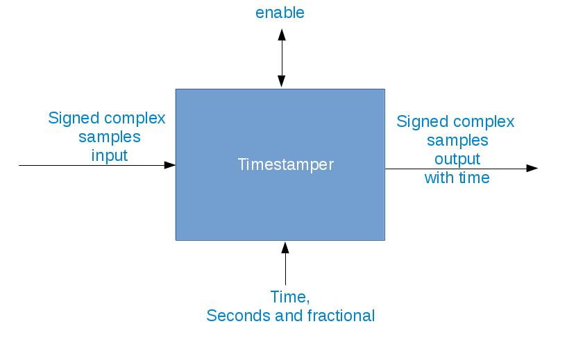

A block diagram representation of the implementation is given in Figure 5:
Timestamper Implementation Block Diagram
Figure 5: Timestamper Block Diagram
Timestamps are provided as an input to the component on the time interface. The timestamp is a 64-bit number with the first 32 bits corresponding to seconds and the last 32 bits corresponding to fractional seconds. When a valid message is detected on the input, the timestamp is registered by the component and given on the output interface. Timestamps and data are given on the output interface using different opcodes.
The time interface from which the timestamps are generated originates from the OpenCPI time server, which is instanced as part of the platform worker. Furthermore, an additional component (time client) is dynamically instanced by the framework for all components that declare time interfaces. The time client communicates with the time server and produces the time interface seen by the component.

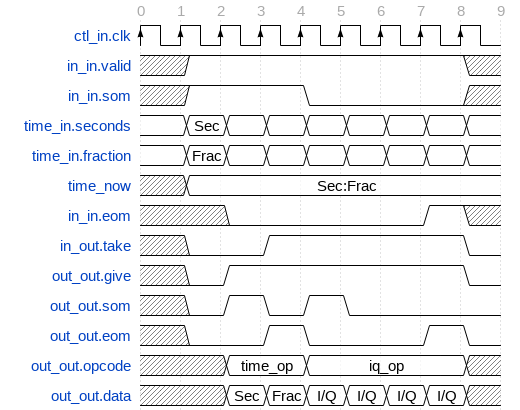

A timing diagram of the output interface for the timestamper component is given in Figure 6:
Timestamper Output Timing Diagram
Figure 6: Timestamper Output Timing Diagram
