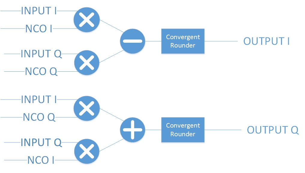

The following figure shows a block diagram representation of the HDL implementation:
Complex Mixer Top-level Block Diagram
Figure 3: Complex Mixer Block Diagram
