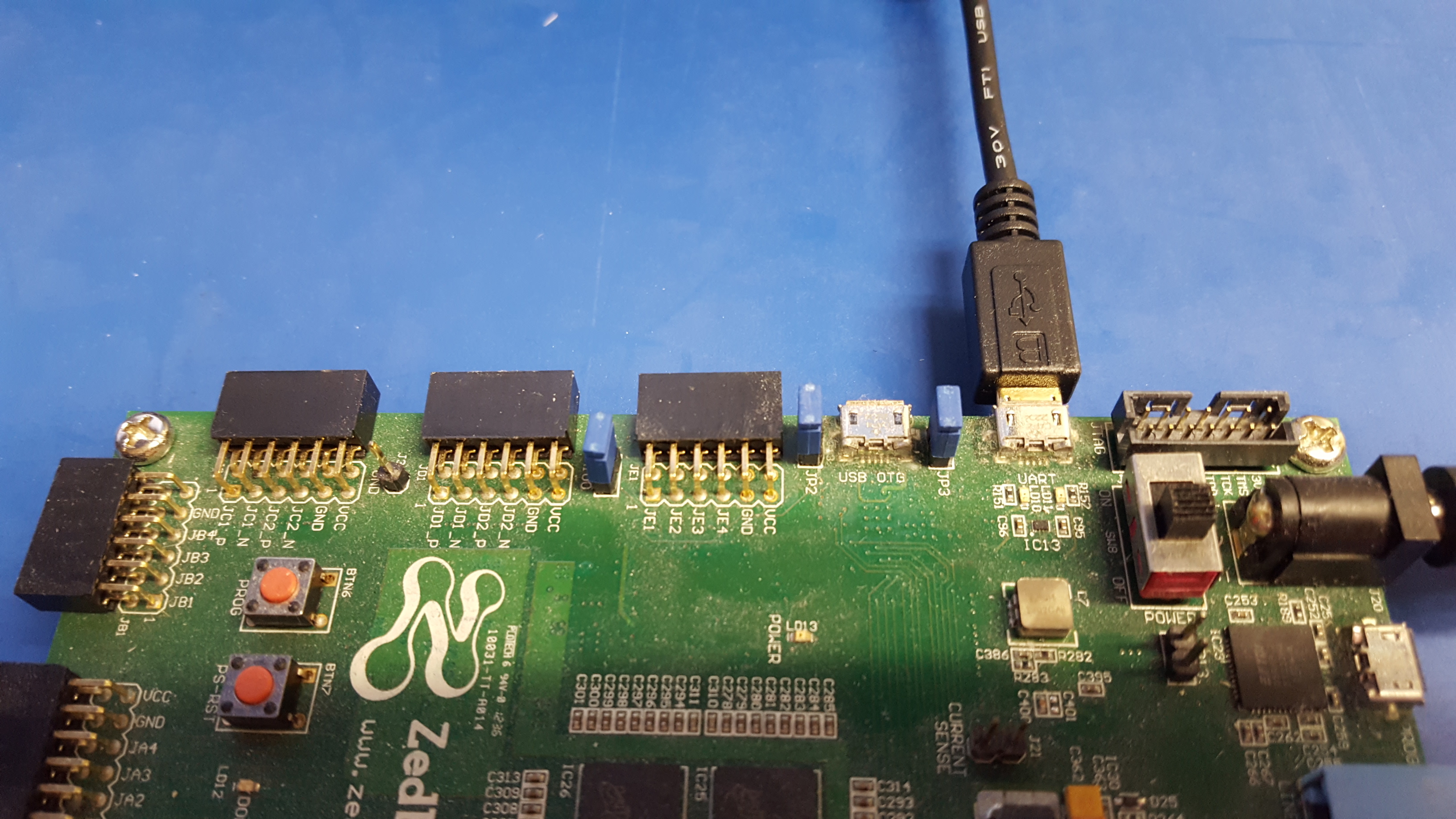

  • On Zedboard systems, the micro-USB serial port, labeled UART and located on the top side of the ZedBoard, can be used to access the serial connection with the processor.
Connected Serial USB
Figure 13: Connected Serial USB
  • The console serial port operates at 115200 baud. The cable used is a micro-USB to USB-A cable to connect its console micro-USB port to the development host.

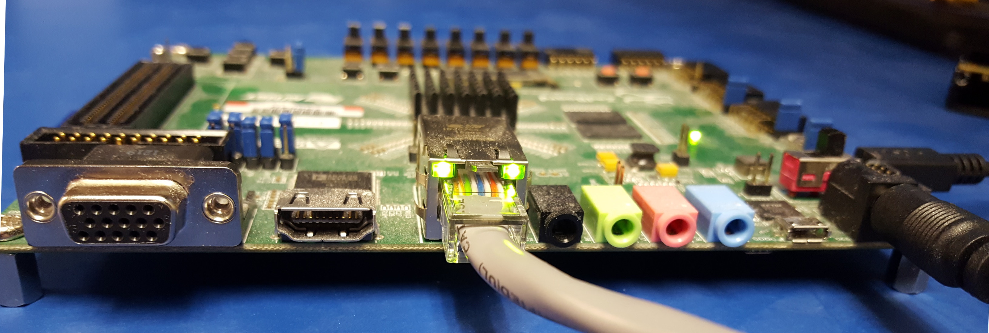

There is one Ethernet port located on the ZedBoard. Use a 1-Gigabit Ethernet cable to connect this port to the DHCP-supported network, as shown in Figure 14:

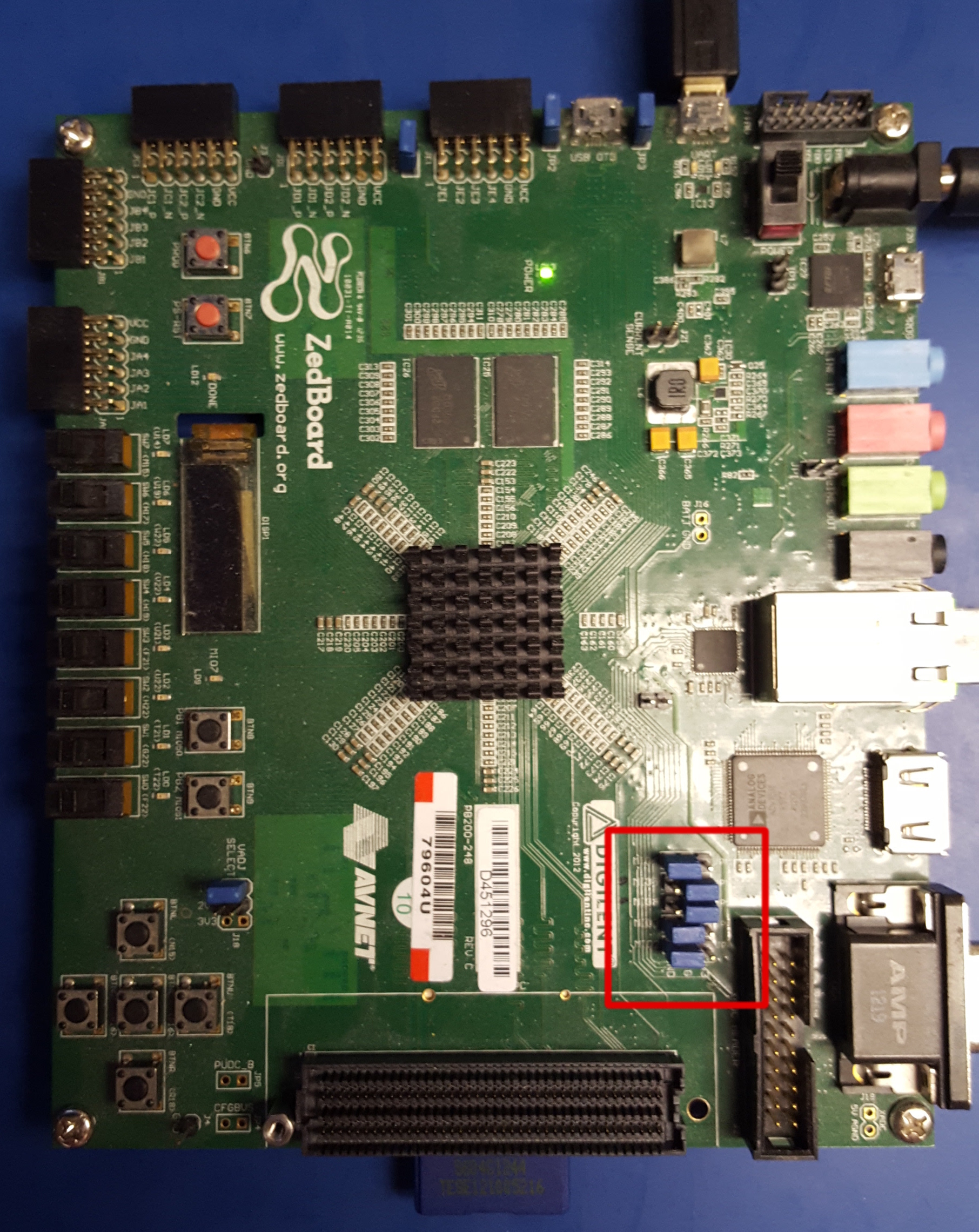

  2. Set the following jumpers on the top of the ZedBoard to boot from the SD card, as shown in Figure 15:
    • Set JP10 to 3.3V.
    • Set JP9 to 3.3V.
    • Set JP8 to GND.
    • Set VADJ SELECT (J18) to 2V5 to ensure proper FPGA Mezzanine Card (FMC) configuration. The only supported FMC voltage for OpenCPI bitstreams is 2.5V.

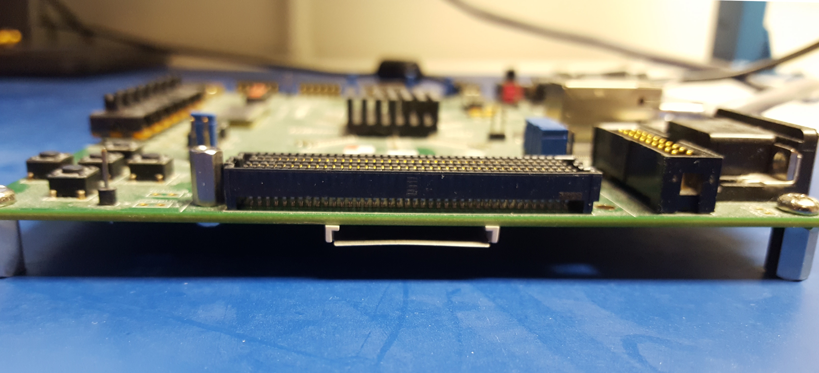

  1. Insert the SD card into the SD card slot. The SD card slot is located below the FMC Low Pin Count (LPC) slot for an optional daughtercard on the bottom side of the ZedBoard, as shown in Figure 16:

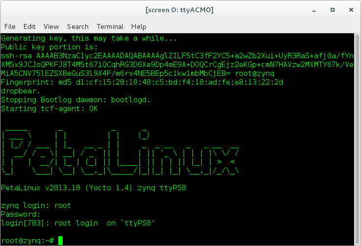

The ZedBoard system is initially set with root for user name and password. Typically, on initial power-on of the platform, the boot sequence will stop at the uboot configuration prompt. When this occurs, simply enter boot to allow the boot sequence to continue:
$ zynq-uboot> boot
After a successful boot to PetaLinux, log in to the system using root for user name and password, as shown in Figure 17:
