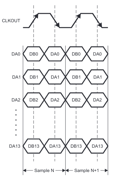

The ADS62P48 transfers captured samples to the worker over a 14-bit parallel LVDS bus with a source synchronous clock. The data is transmitted as centre aligned double data rate (DDR). This is illustrated by the following diagram from the datasheet:
../../../_images/centre-aligned-ddr.png

For each data lane an IDDR element is used to capture the bits on each edge of the DCLK. In order to correctly sample the signal clock-to-data delay calibration is required (see Calibration); to support this the delay value of the IDELAY elements can be configured via the idelay_value property and a pattern checker is implemented to detect correct data reception.
