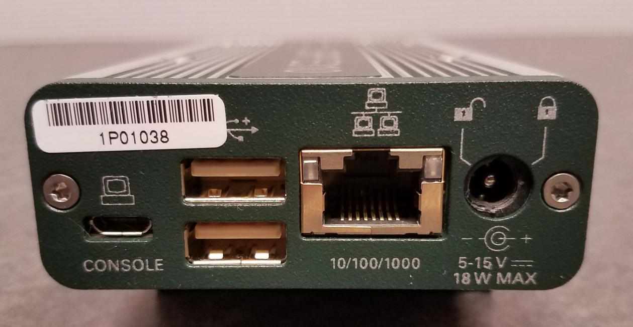

Using network mode for OpenCPI on the E310 USRP requires establishing an Ethernet connection from the E310 USRP to a network that supports DHCP.
There is one Ethernet port located on the E310 USRP’s rear panel, as shown in Figure 1:. Use the 1-Gigabit Ethernet cable provided in the E3XX product package to connect this port to the DHCP-supported network.

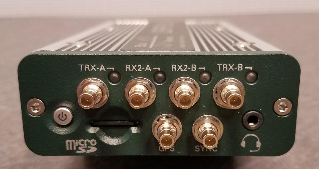

The bootable SD card slot is located on the E310 USRP’s front panel. To eject an SD card, gently push it in and then release it.

The E310 USRP front panel provides six SMB (50 Ohm) connectors labeled TRX-A, RX2-A, RX2-B, TRX-B, GPS, and SYNC. These connectors are not relevant to enabling OpenCPI on the E310. See the Ettus Research USRP Hardware Driver and USRP Manual for details about their function.

On the E310 USRP, the micro-USB serial port is located on the system’s rear panel (see Figure 3:) and is labeled CONSOLE. Connect the micro-USB to USB-A cable supplied in the product package from this port to the development host.
The USRP E310’s console serial port operates at 115200 baud.
